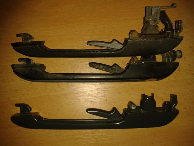

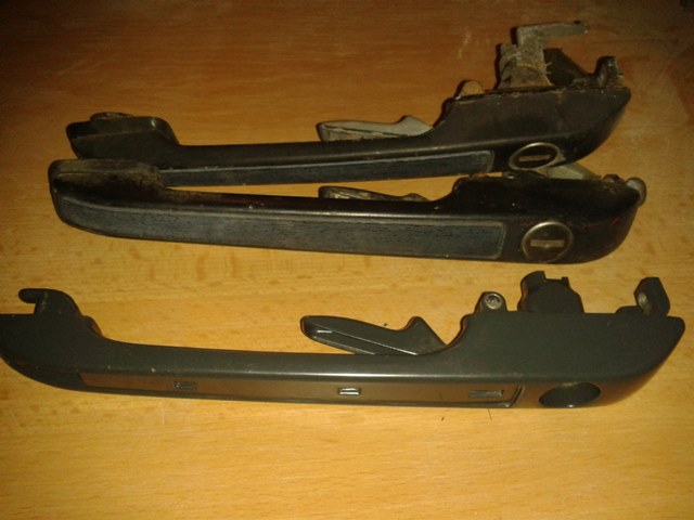

Here are two pictures which shows the differences between 176 and 177 - door handles.
The new one is 176...and the two used handles are from 177:

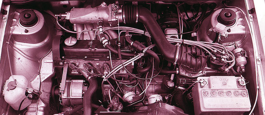

The old valve cover from 176 has little openings near to the cylinder-head. In this openings you can see the packing!
In 177 the openings are closed!

But as already exchanged on the picture taken in Juni 76 for Automotorsport July 76 edition, we can see the "176" engine with all the specificities including the valve cover than.

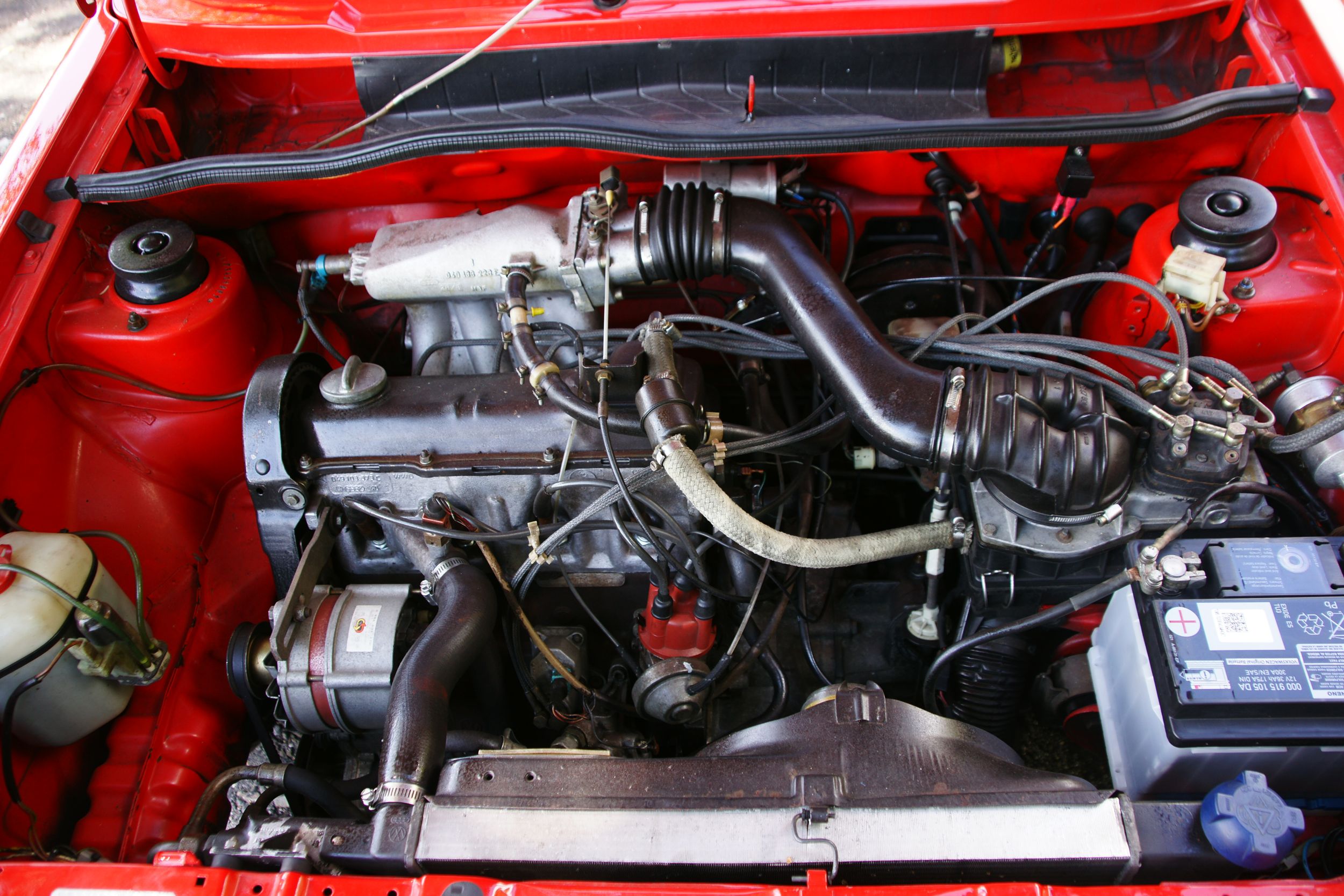

Same for the picture here (august 76 models???)

Finaly having observed 76' golf GTI (176 as much possible.. almost none remaining) and the "US" sister Rabbit with EE and EF from 76 ; I'm almost certain that the short GTI production planed end of 1976 year model in Wolfsburg has been planed based on EE and EF cars body and electrical caracterstics (wires color codes are also different right?).
This could explain why the injections parts are so much different from the following 177 GTI models, why the hooks are under the bonnets, why a welded support for the "EE /EF" deppresion system is behind the diagnose box(under the bonnet over Left Macpherson) why some additional control connections are there (blue connection over the injection metering plate).
The EE and EF cars, available for US Canada and Japan (?) begining of February 1976 were fitted also with K-jetronic, exaust gas recycling , catalysator and other. This to satisfy the strong emission rate asked for somes states as California in 75'.
And also, the hooks under the bonnet disappeared in 78 GTI Models. That's exactly the moment when the US assembly plant Westmoreland has to start to produce their own Rabbit.. :D
Very interesting ! :wink: :D
But I persist to say that the first GTI cars in Juni 76 didn't have the hooks under the bonnet ! :wink:
And with the specific valve cover, there was also a specific gasket (the same was also on the swallowtail cars !) 8)

matthias_vwauto a écrit :Here are two pictures which shows the differences between 176 and 177 - door handles.
Best regards
Matthias
Sorry, i think your 176 model isn't the good one, the good model for a 176 GTI is:
