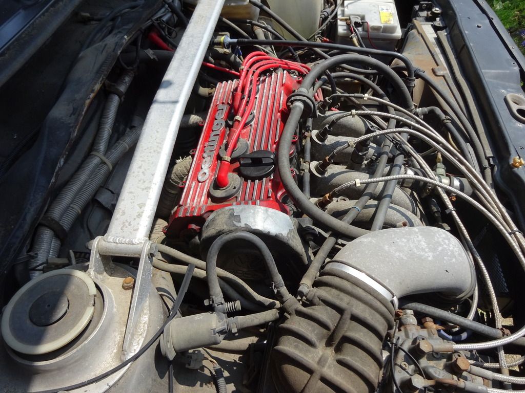

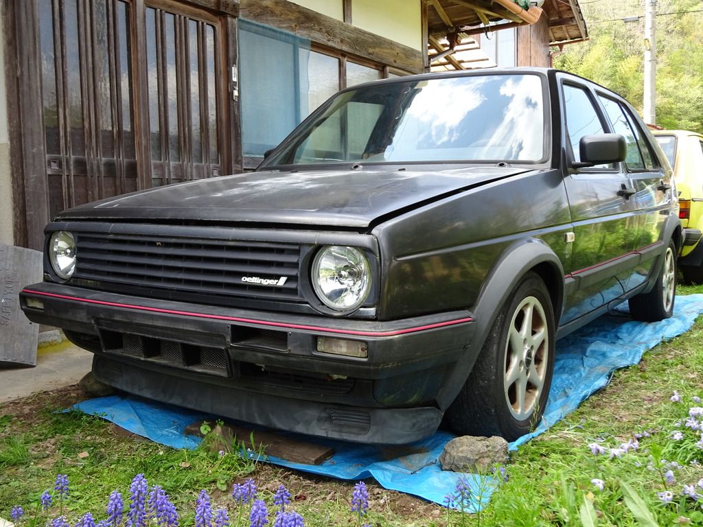

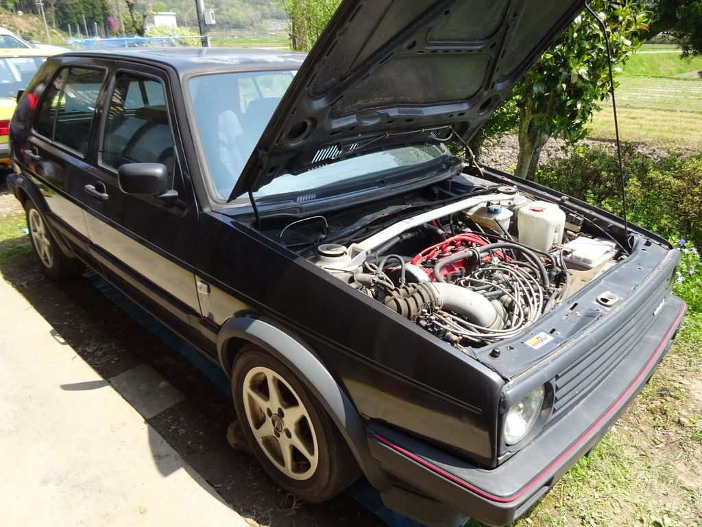

My name is Makky from Japan :D
I've got legendary Oettinger 16s today :up:
1800E/16, not a 2000E/16. More rare? or not?

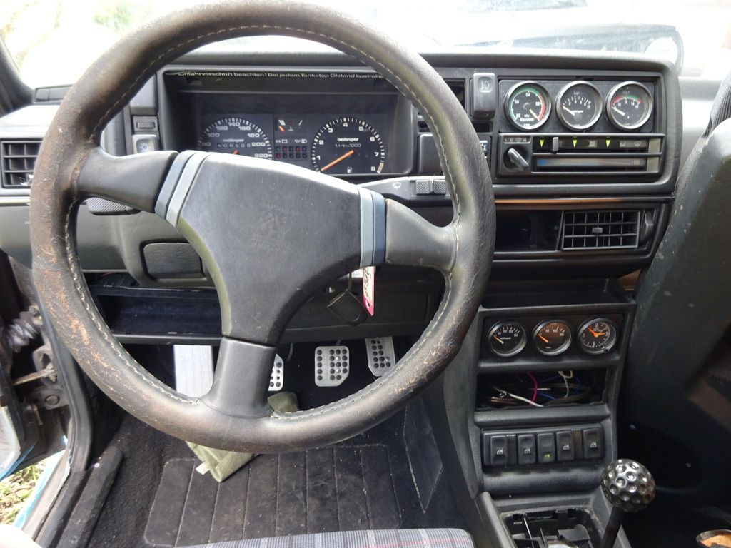

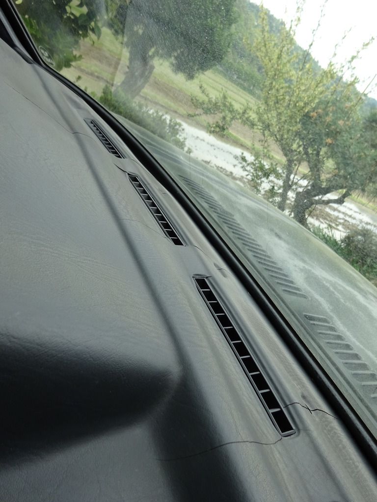

Cracky dashboard.

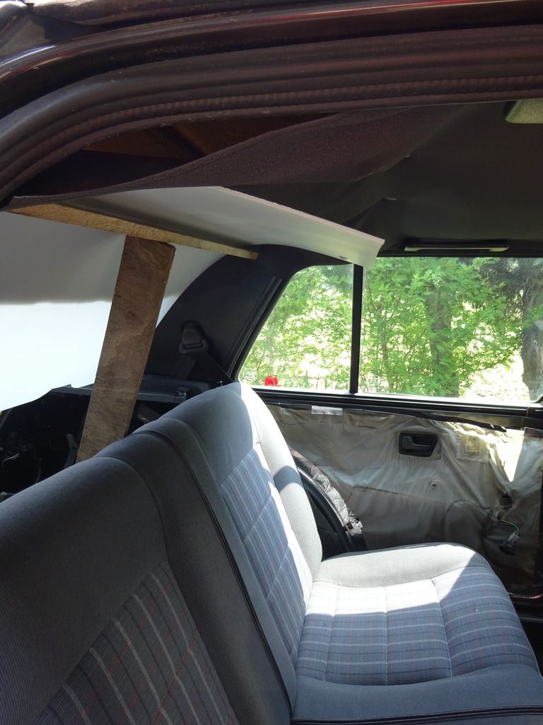

Pealed headlining.

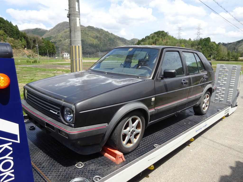

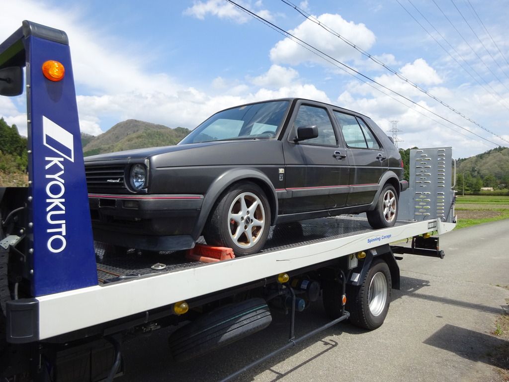

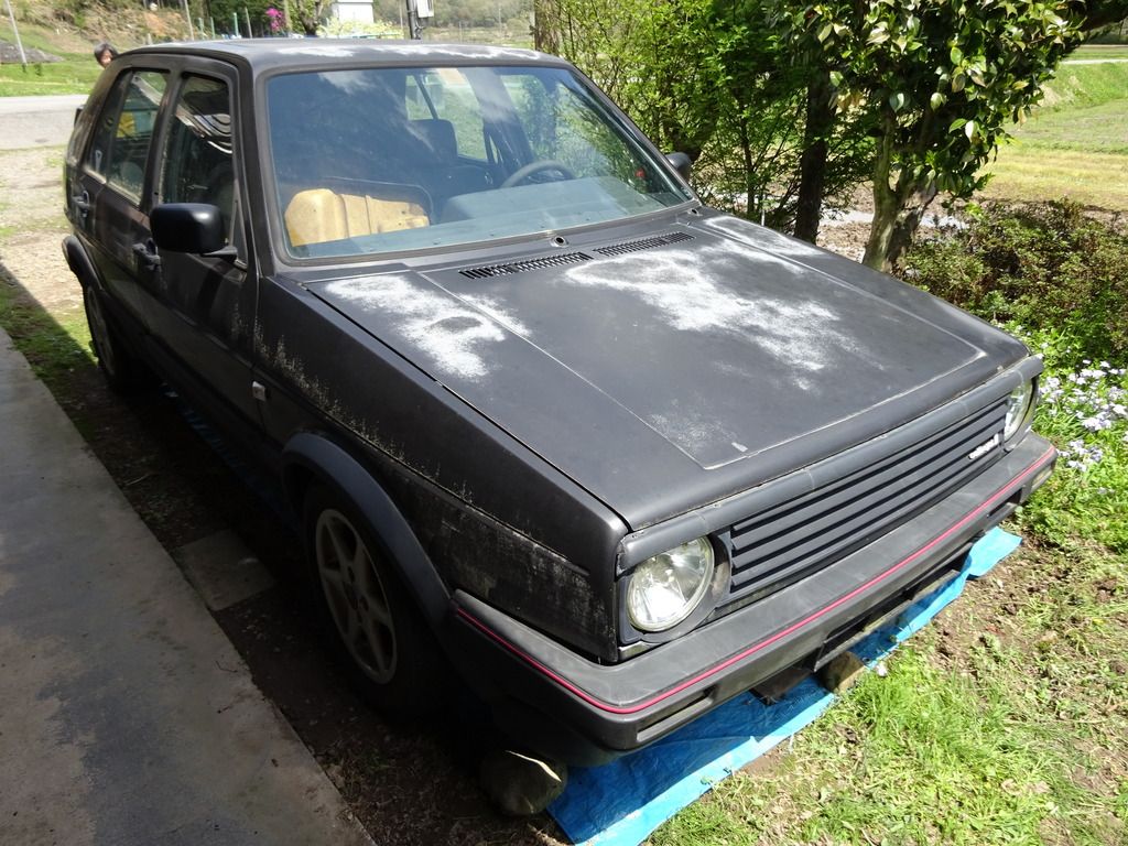

He had been stored in the automotive shop more than 10 years and need a lot of works to start the engine.
Body and the interior also damaged due to the long storage under the sun and moisture.
Previous owner(automotive shop) doesn't have any passion to repair this machine, so I could buy oettinger only a 1000EUR :shock:
Anyway, I'm really excited to able to be an Oettinger owner and I'd like to share the progress with everyone here :)

There is a lot of work ,
But ....my god..... A very very rare complete modele :o :o !
Just i think , why on a 4 doors? Might be better on a 2 door modele !
But very FULL rare modele which you have to take care :up: :up: :up:

Which version it is? There was 1800E/16v = 150cv
1800E/16v= 162cv
2000E/16v= 170cv
I read 1800E but can't say which one

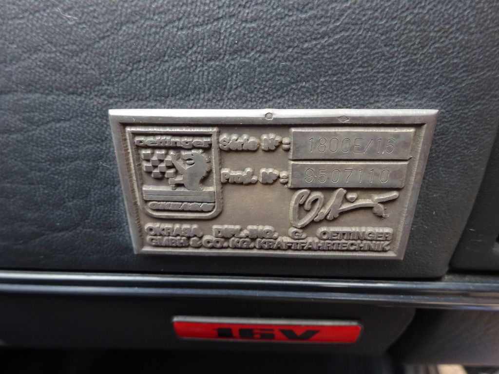

Thanks,

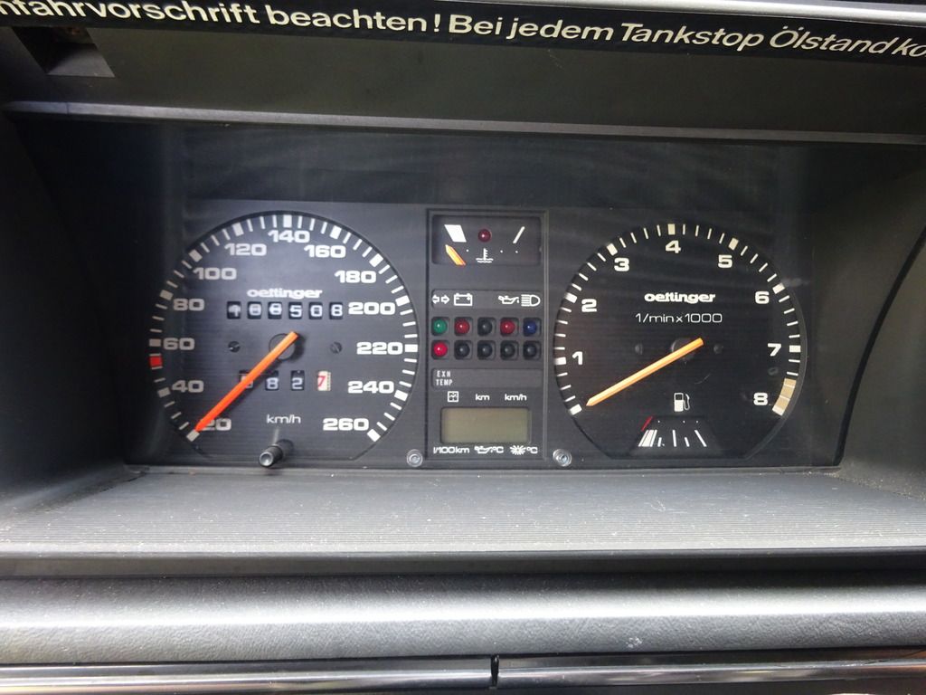

I could find only a name plate on dashboard, but do you know how to identify 150CV or 163CV ?

Hello
I think you can call or send a email at Oettinger GMBH at Germany to know which version you have (with the plate on dashboard or the constructor plate)

I will ask someone, maybe he could explain us which version you have . He has a Mk2 2000E/16v Oettinger 170cv , and that's this guy explained me the version of the Mk2 Oett', but he detailled me the modification only the 2000E.
I can try to inform ;)
Take care of this 1800E/16v :D
Re: 1988 Oettinger mk2 from JAPAN
Hello and welcome here, that's a nice gift !!!
1800E/16 163cv is on a KR 16V basis, you have the 1800E 16/150cv , and its base engine is the EV (idem DX).
Which are the difference vs the 2000 E/ 16?
The 2L is a long stroker (94.5 mm) and the engine block was rebored up to 81.5 mm with new pistons, in the 1800 they just changed the 81 mm pistons, in adaptation to the new head! Its shorter stroke (86.4 mm) allows higher rev's.

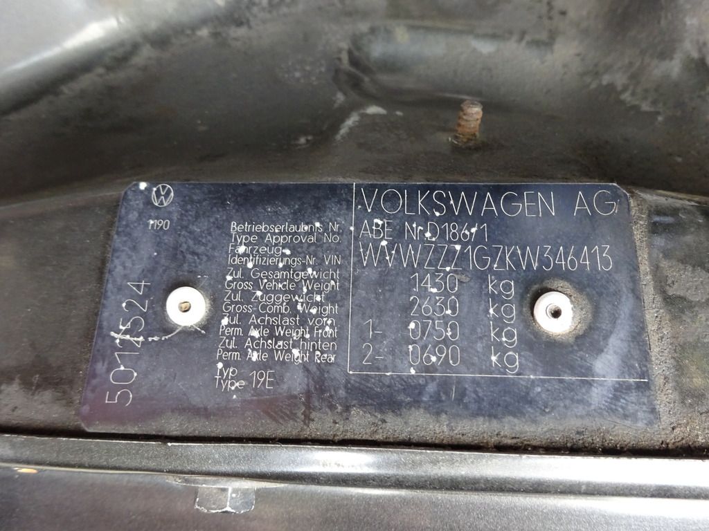

Built in december 1988, I wonder Oettinger still fitted their heads as the KR was in production!
