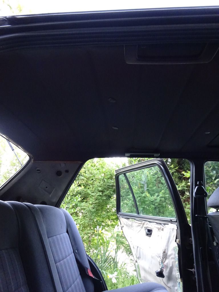

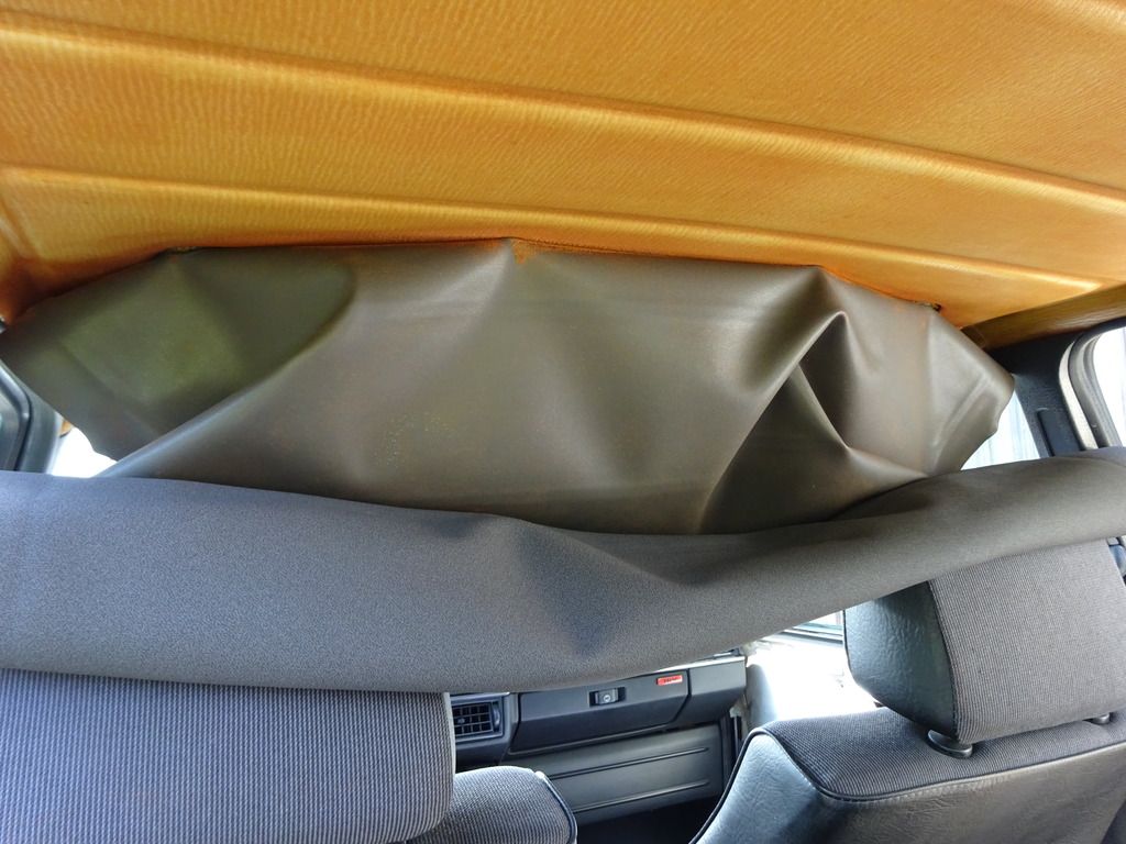

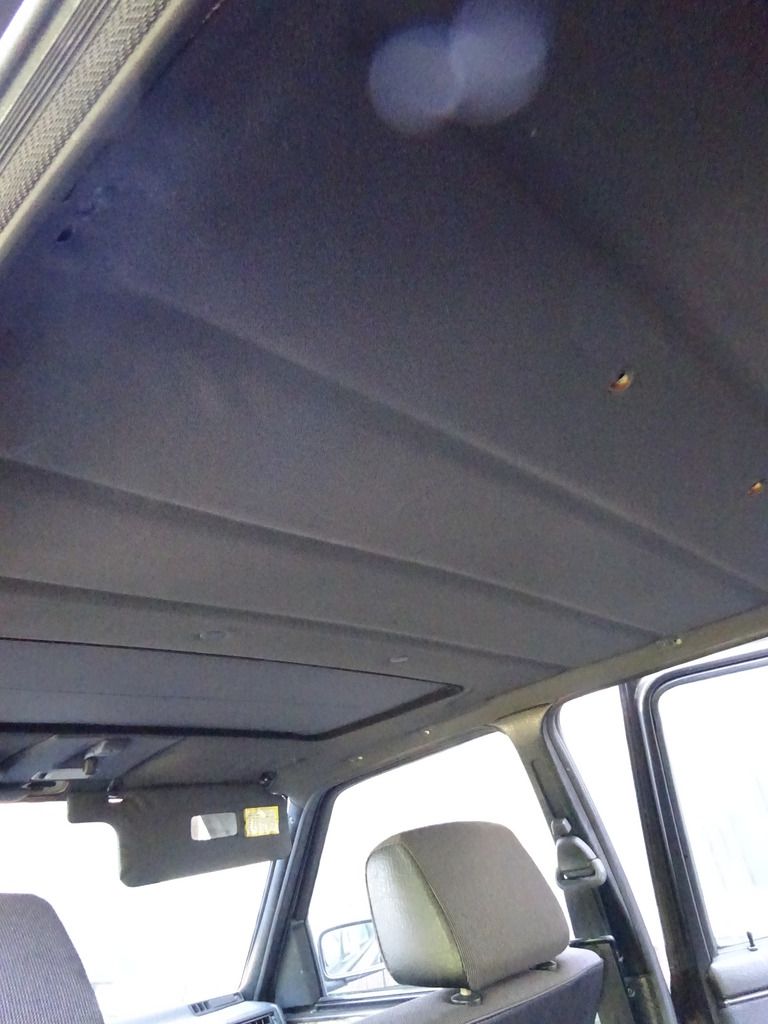

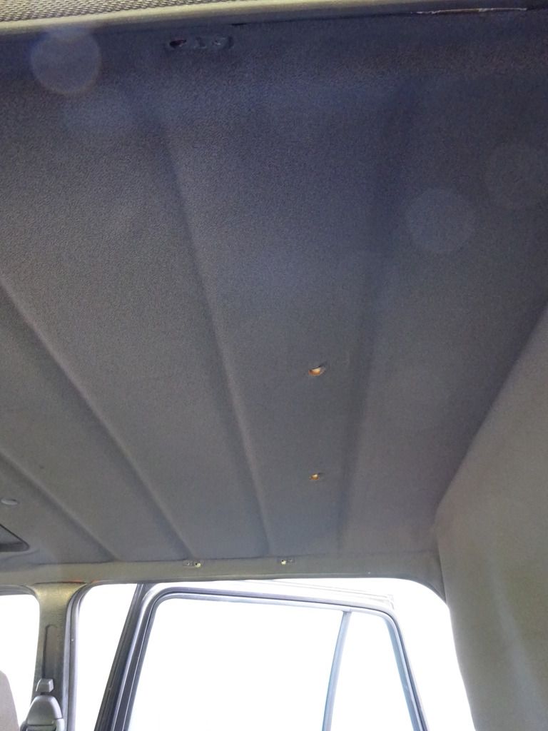

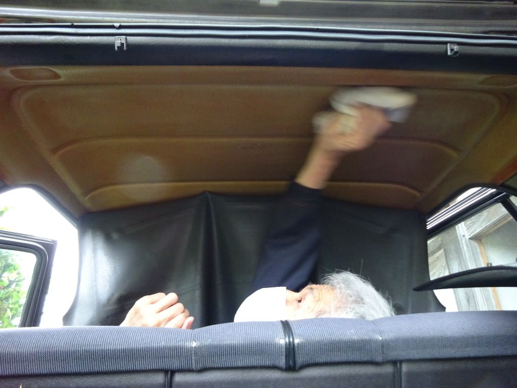

Tried fixing pealed headlining
:top:

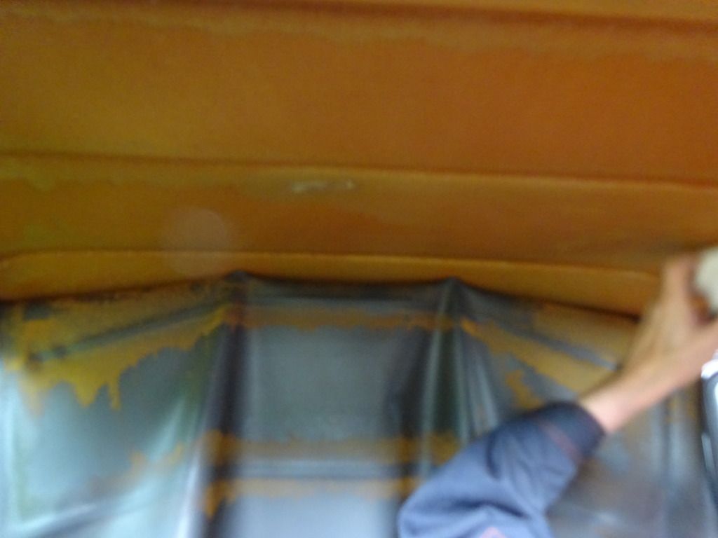

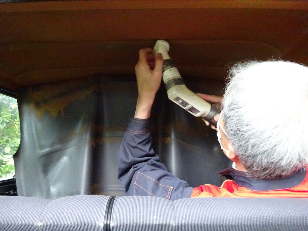

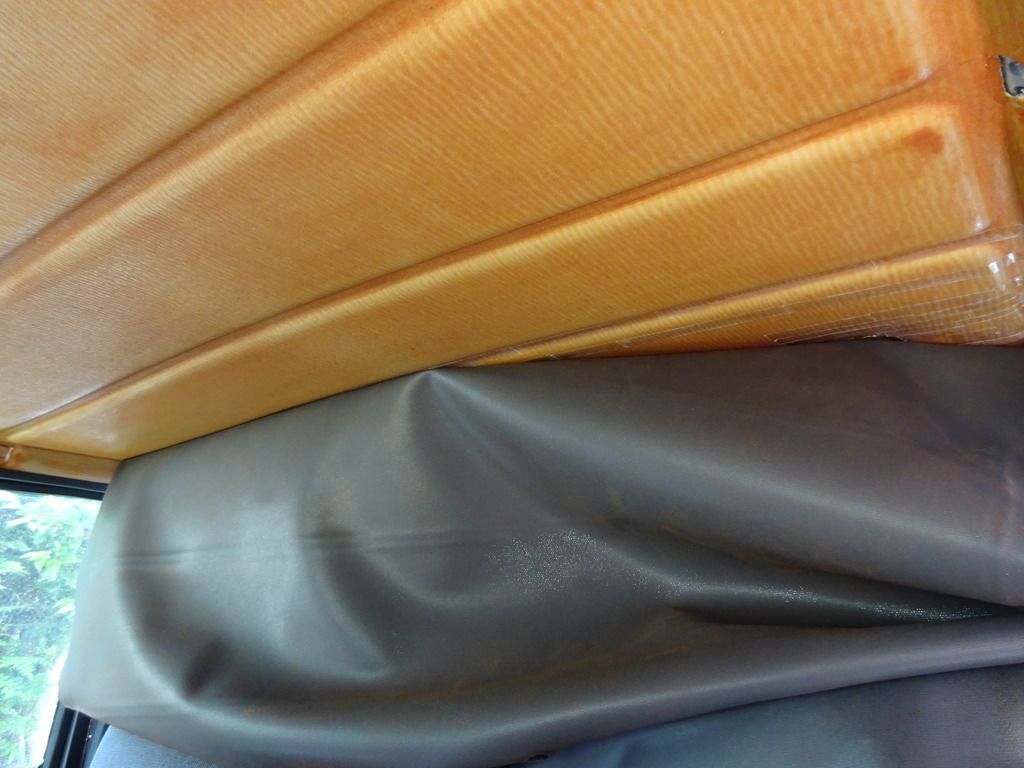

Clean up by using cleaner and wet towel.

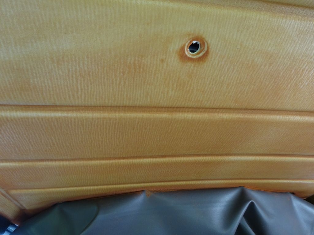

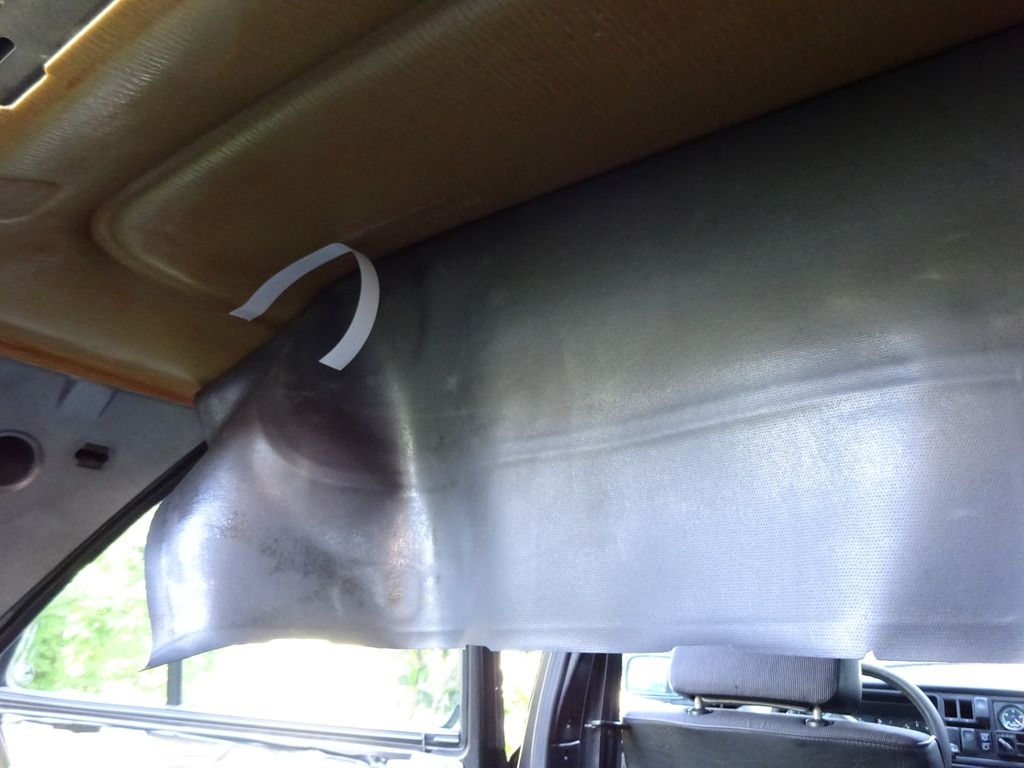

Decomposed spongy substance is covering the surface of padding and inside of fabric.
I couldn't stick or glue anything on padding and fabric without removing this
Cleaning padding gently, it turns into whitish and Polystyrene foam is exposed.

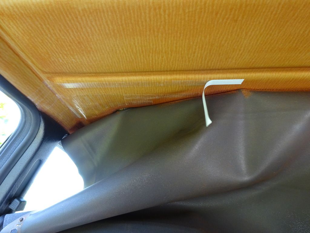

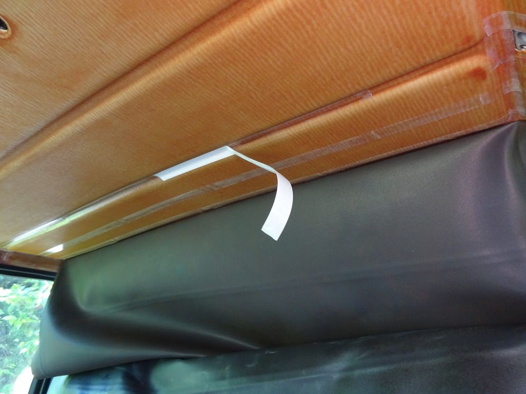

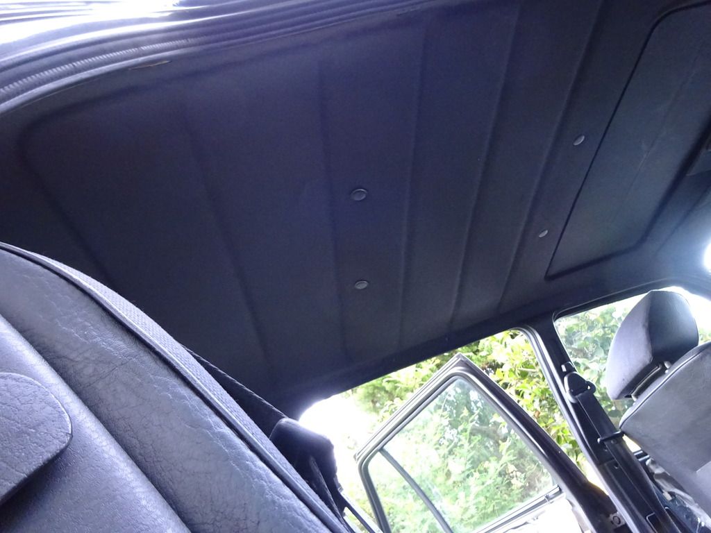

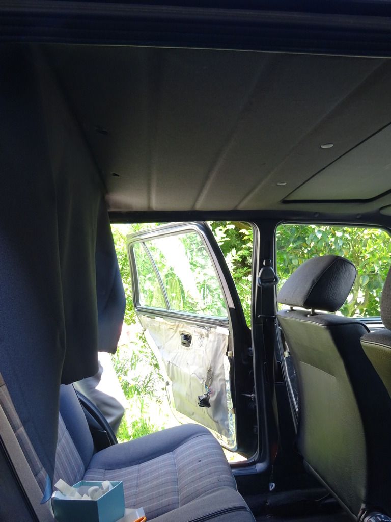

Then I used doubles side tapes and started to glue the lining fabric onto the base form :)

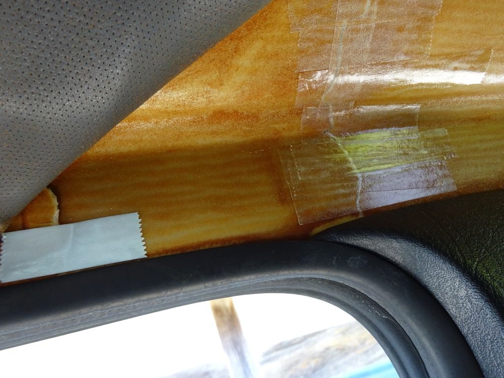

Reinforced the cracked place a little.

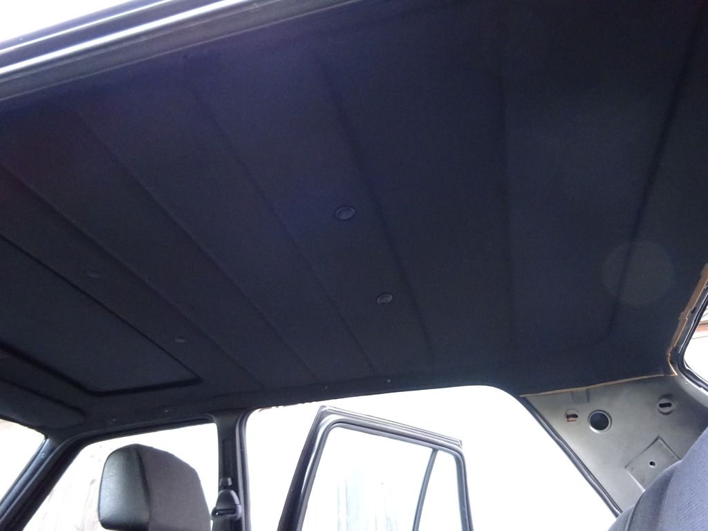

Not so bad as I expected ! :up:
Quite favorable ! :lol:

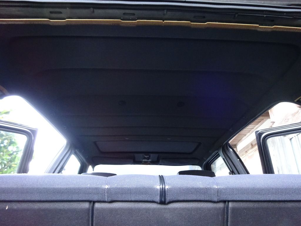

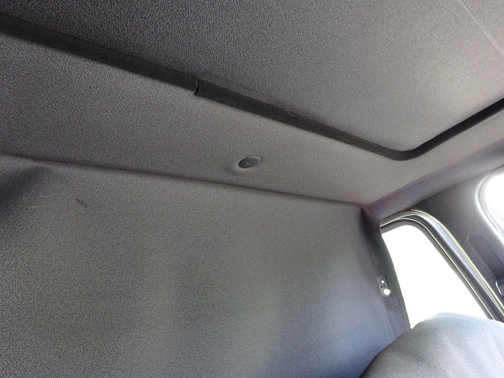

The last part.
Then FINISHED!
I'm really satisfied as a DIY revel quality :bravo:
I thought that this would be a hardest part of the restoration, but it went pretty smoothly :up:

This is a really good job.
:up: :up: :up: :up: :bravo: :bravo: :bravo: :bravo: :bravo: :bravo:

Very interesting. ! :up: :bravo:
But I hope that the glue of the double face will hold with the warmth. :wink:

Re: 1988 Oettinger mk2 from JAPAN
Message par makky »
Andy a écrit :Very interesting. ! :up: :bravo:
It's not certain but I chose the one which can be used in outdoors and durable under high temperature.
Anyway, let's see what will happen :lol:
Message par makky »
SebLM a écrit :Great!
It was not easier to deposit it to make this operation ?
The key is how to remove the spongy things thoroughly :bien:
The fabric can be spread well in the warm weather and fit easily.
The main thing being that all the old glue was removed to assure a good behavior of the fabric in time. :top:
