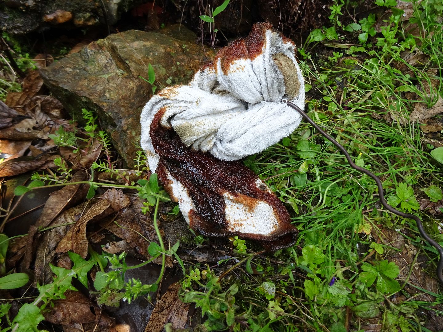

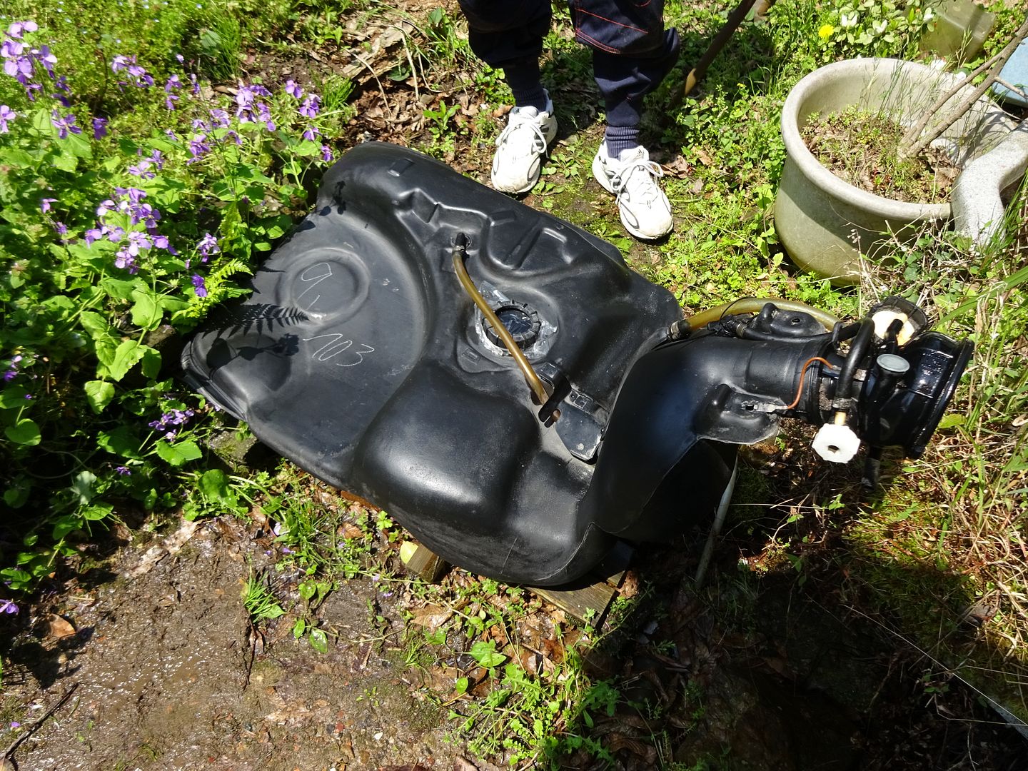

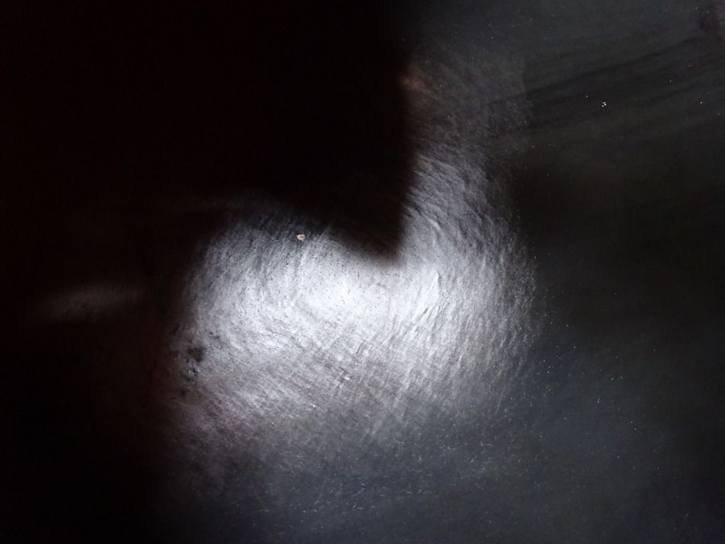

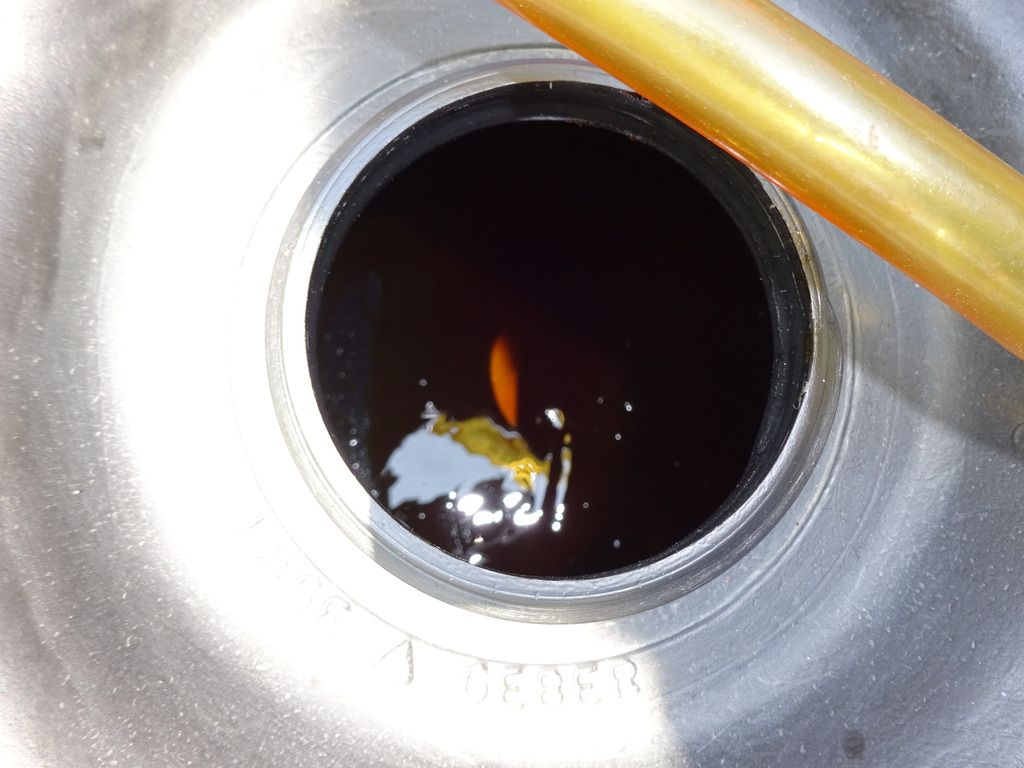

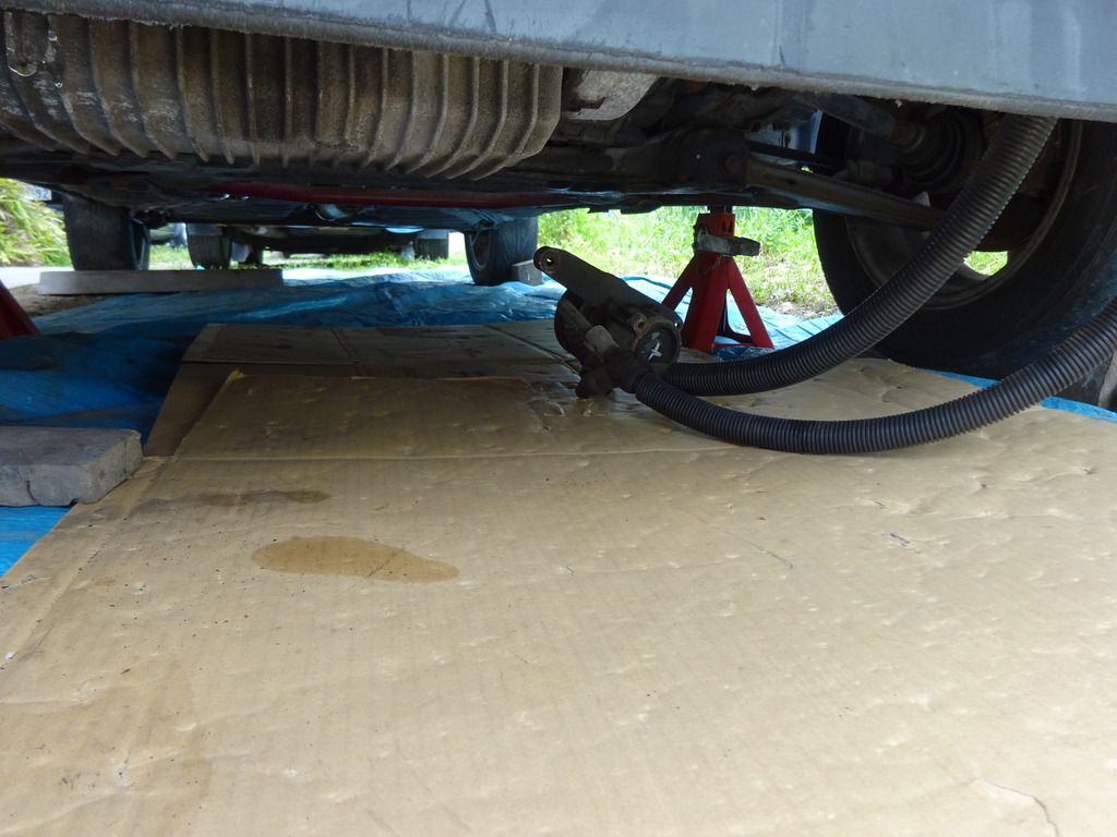

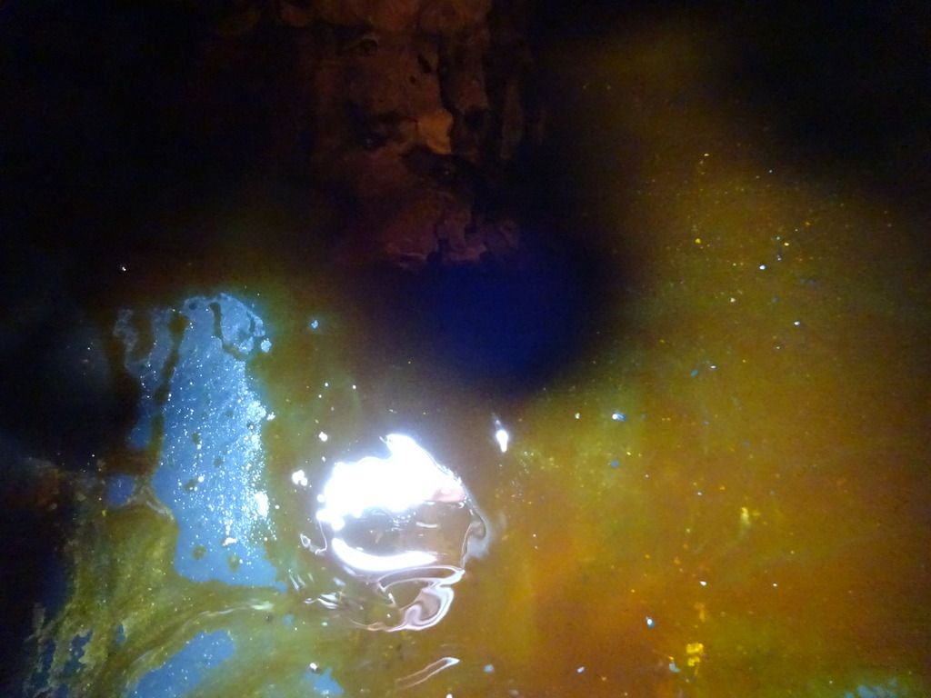

Cleaning up the inside of fuel tank.
We used waste cloth binding with the wire and wiped the tank.

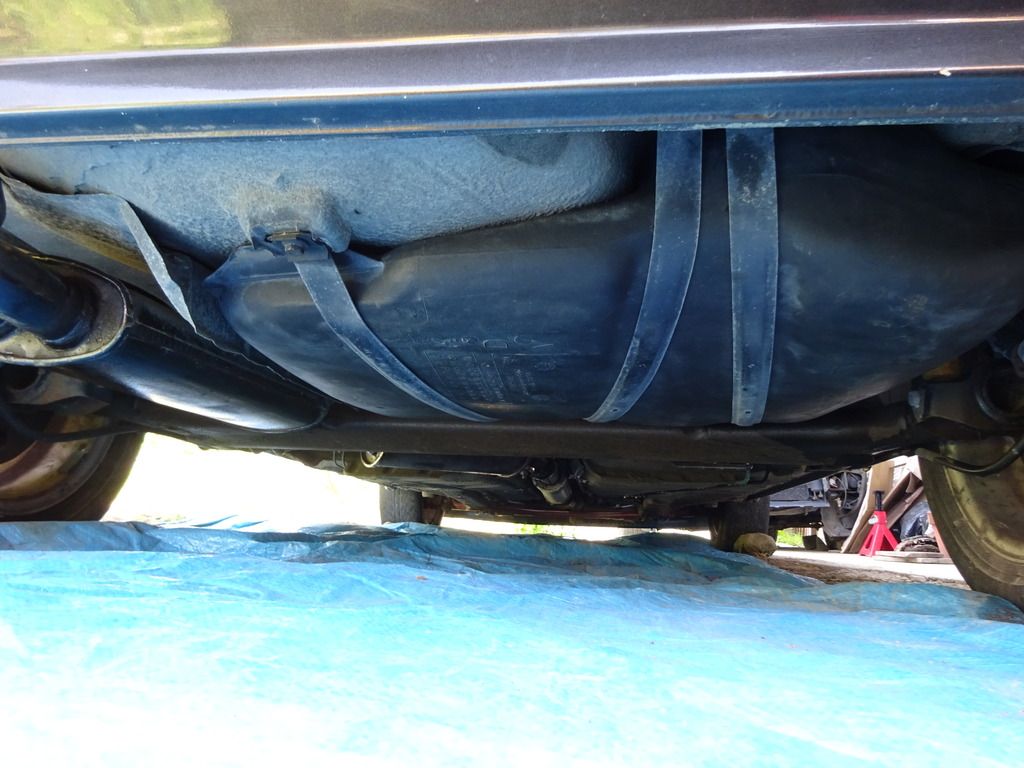

Took out the fuel pump and casing.
There're no signs of leaking fuel, but I have the other casing which I got it from other 16V and I'm going to swap with it.

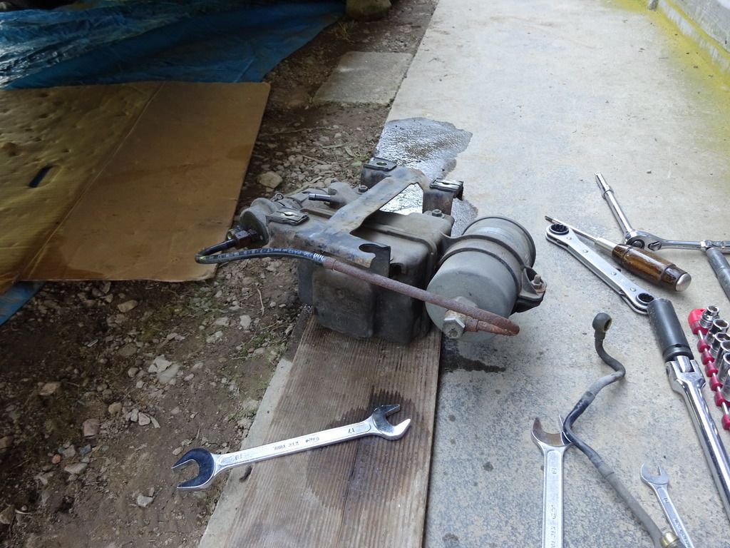

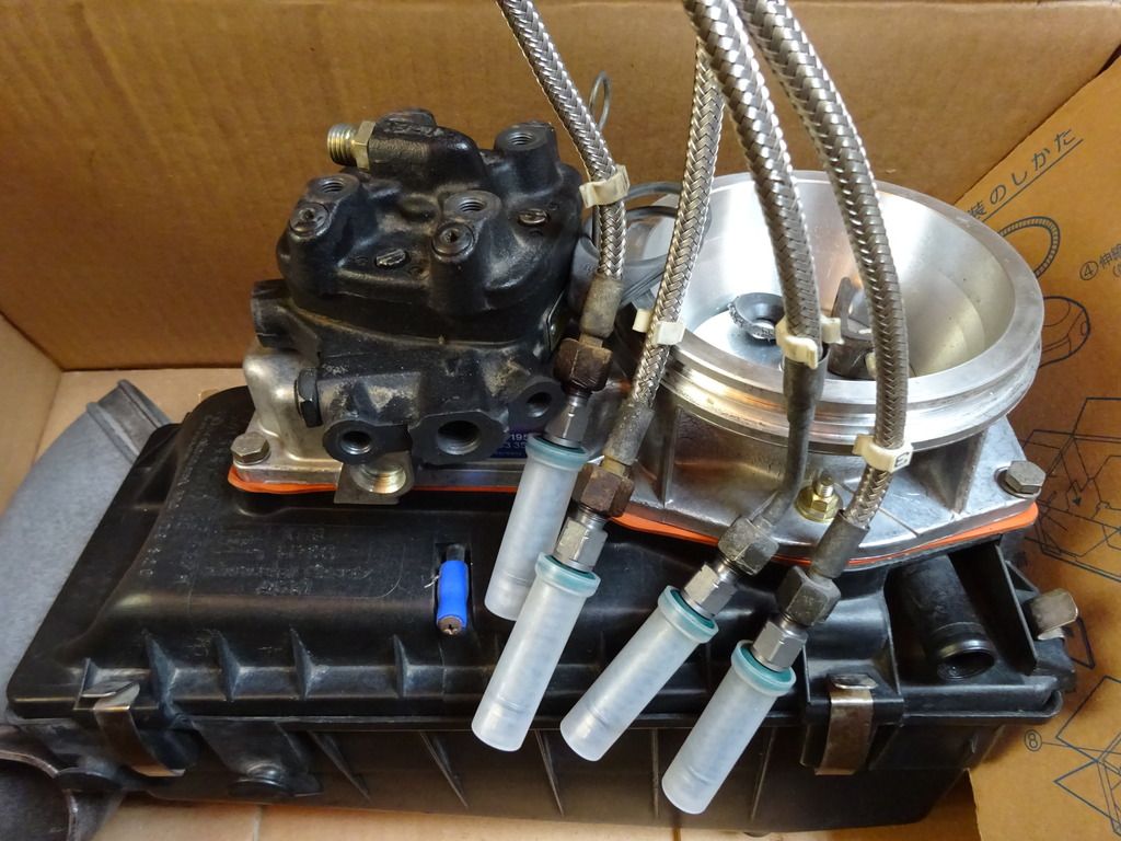

Fuel distributor is not in good condition :?
The needle valve is stacking completely and need to disassemble the FD body.
It’s gonna be a waste of time, so I decided to unpack the New FD and Airflow meter which I got few years ago.
There were no plans for the possible future projects and I bought it 'Just in case' at that point. :lol:

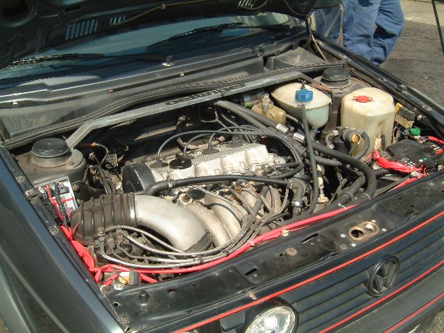

Moved to the front end.

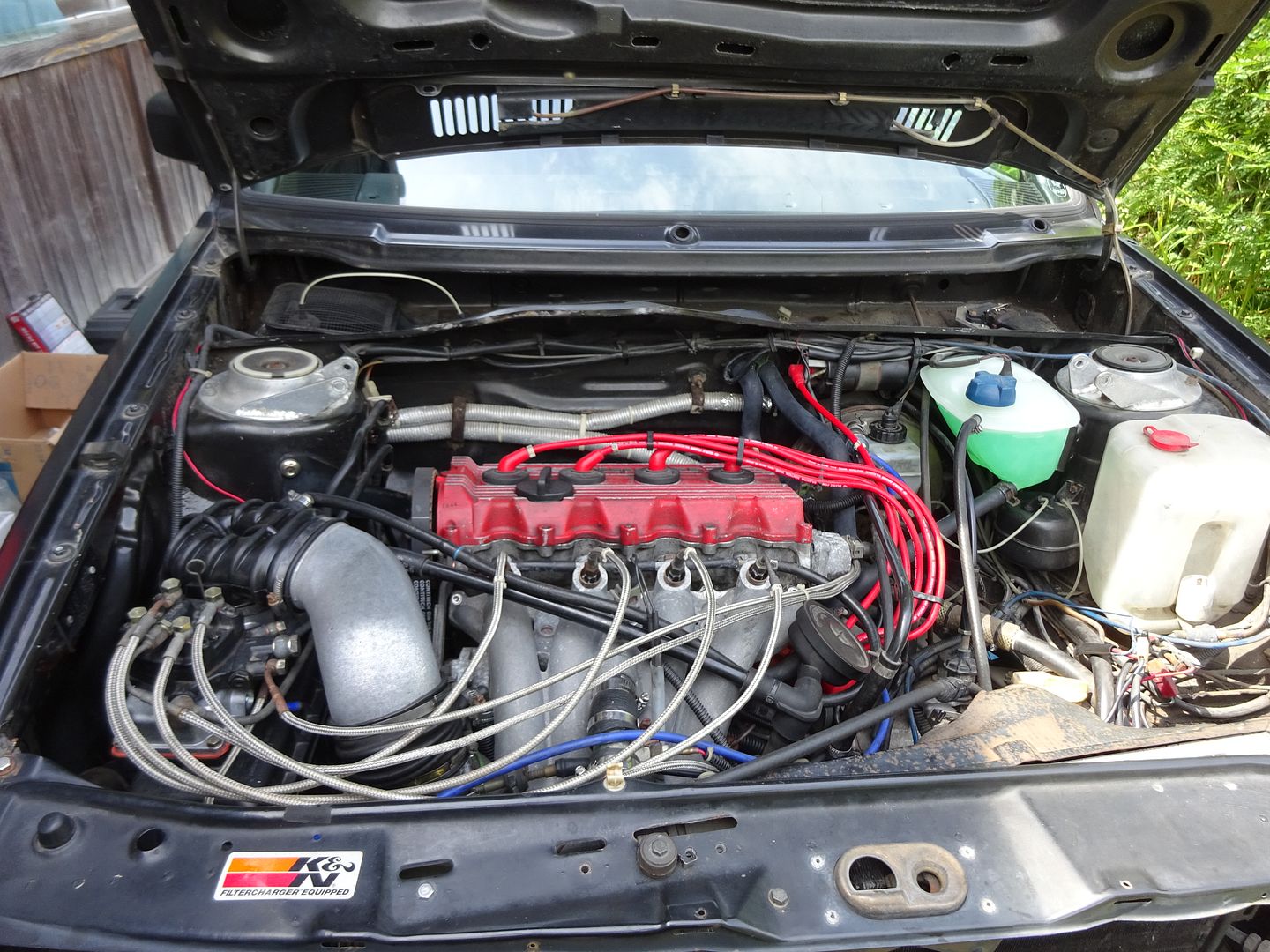

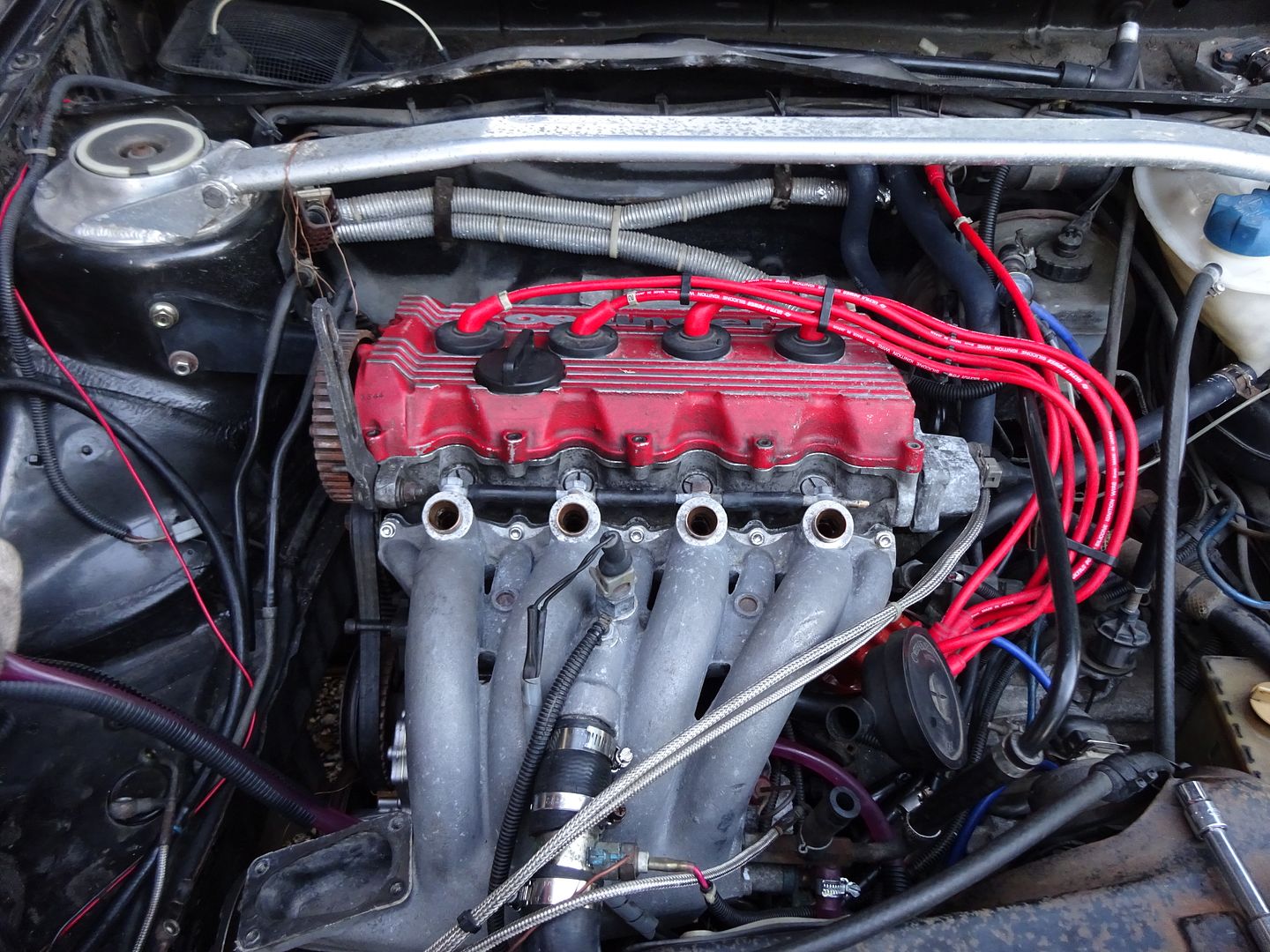

There're extensive work around the engine bay 8)
I don't know how previous owner handled this car and it's too risky to run the engine now.

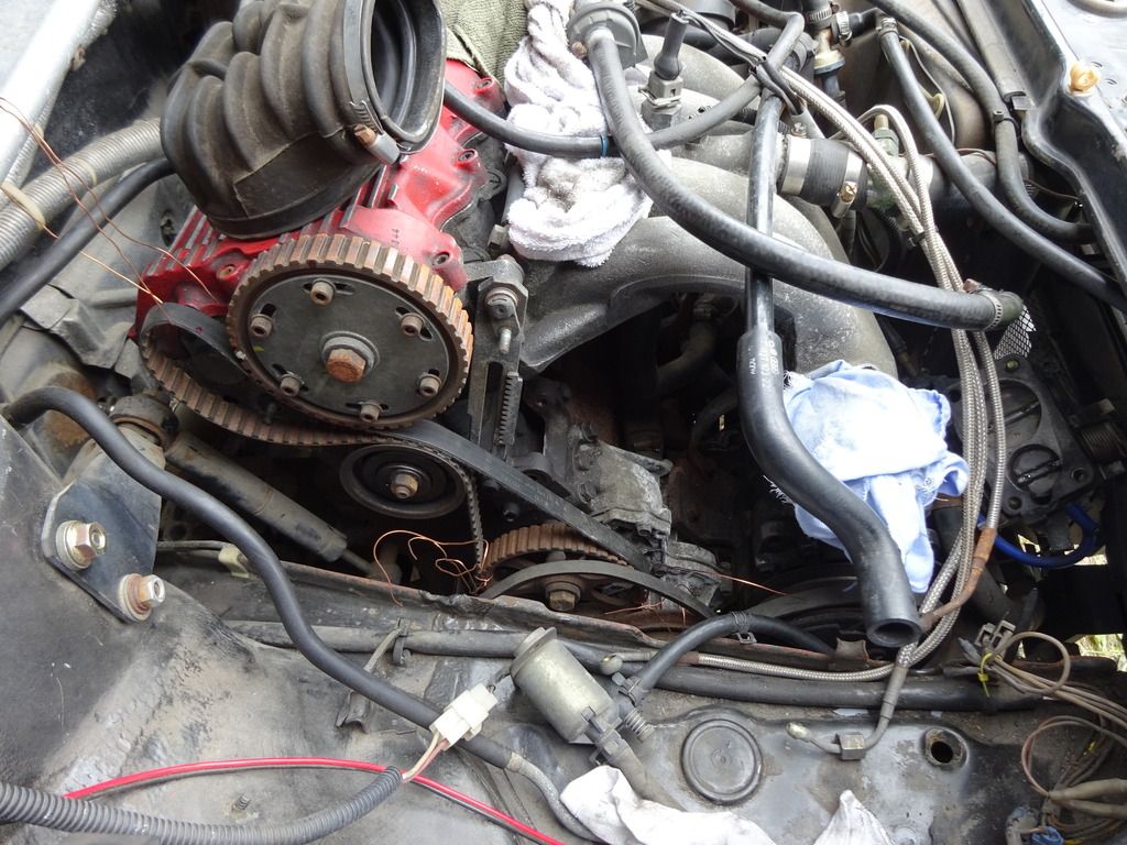

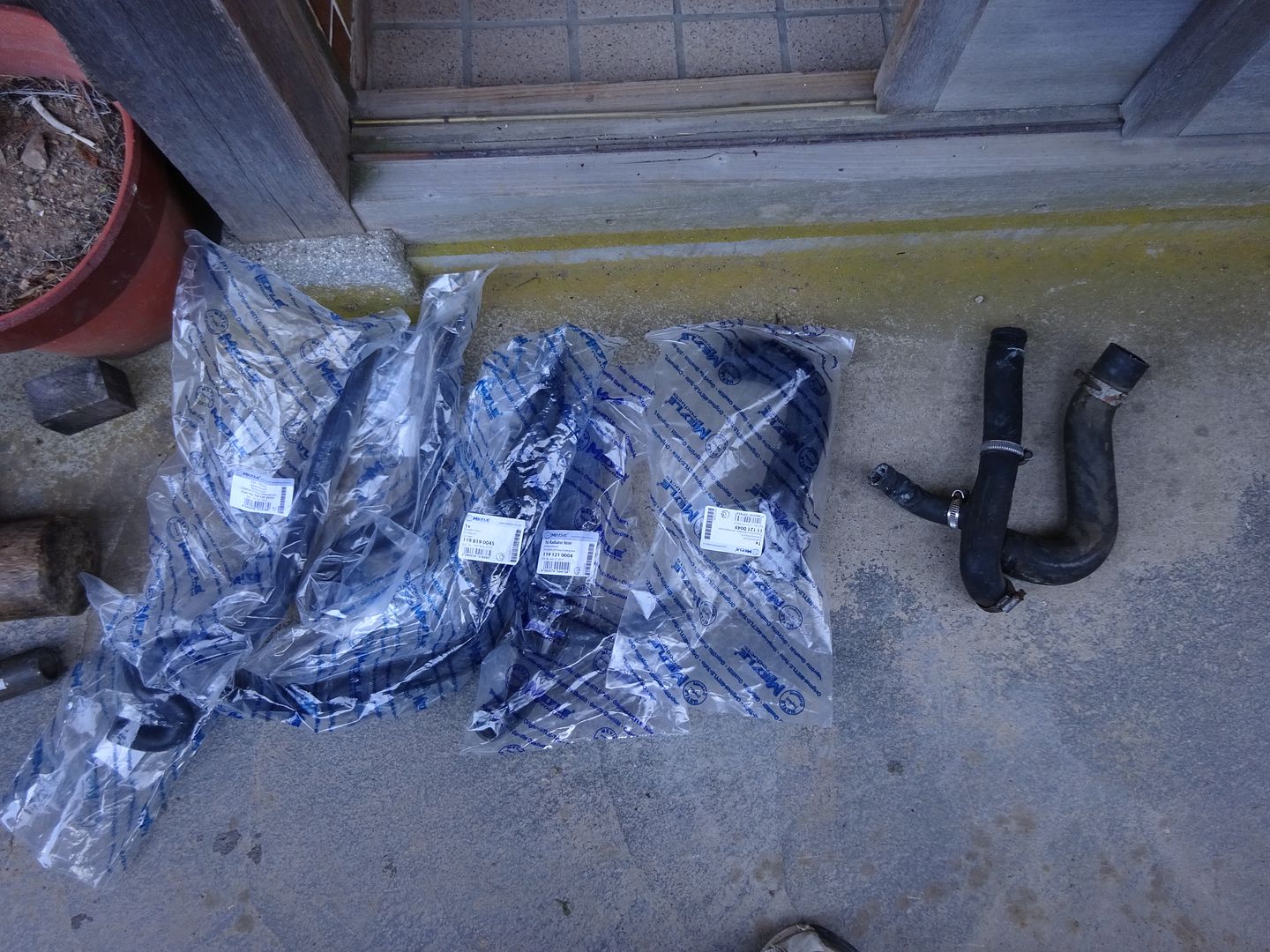

So I started to change water pump, generator, intake gaskets, toothed belt and the whole water hose :clindoeil:

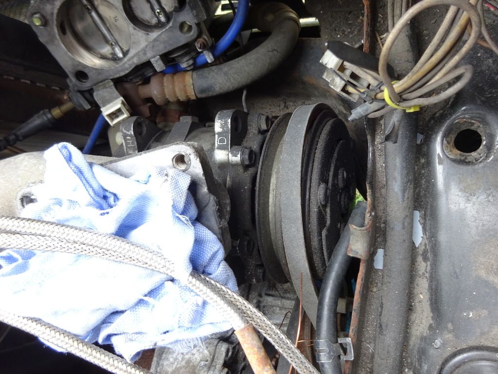

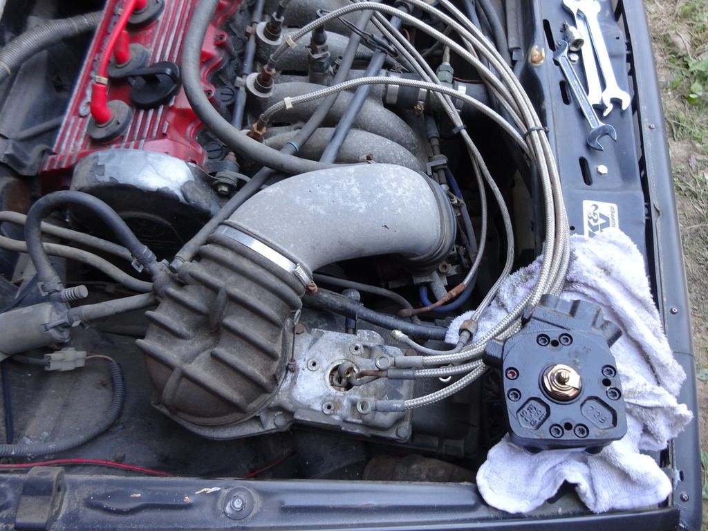

Took out the generator and throttle.
Took out the power steering pump.

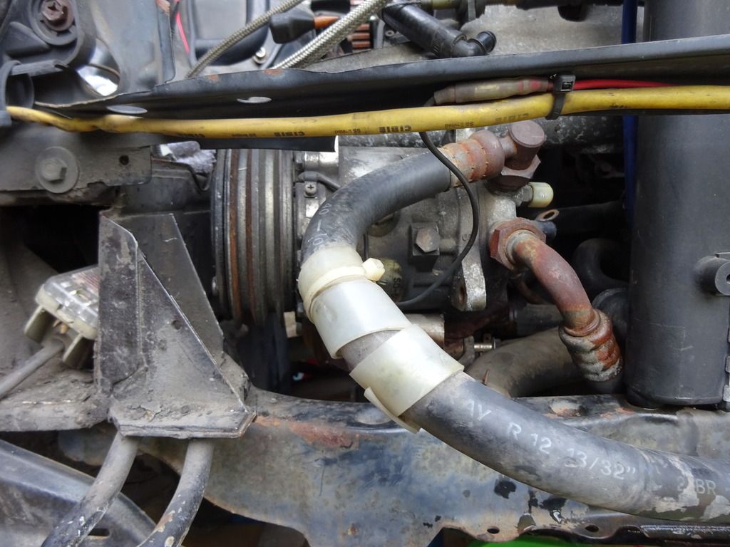

Remove the compressor.

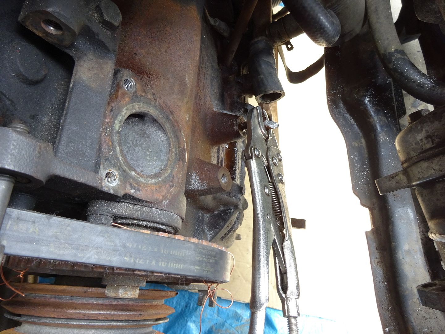

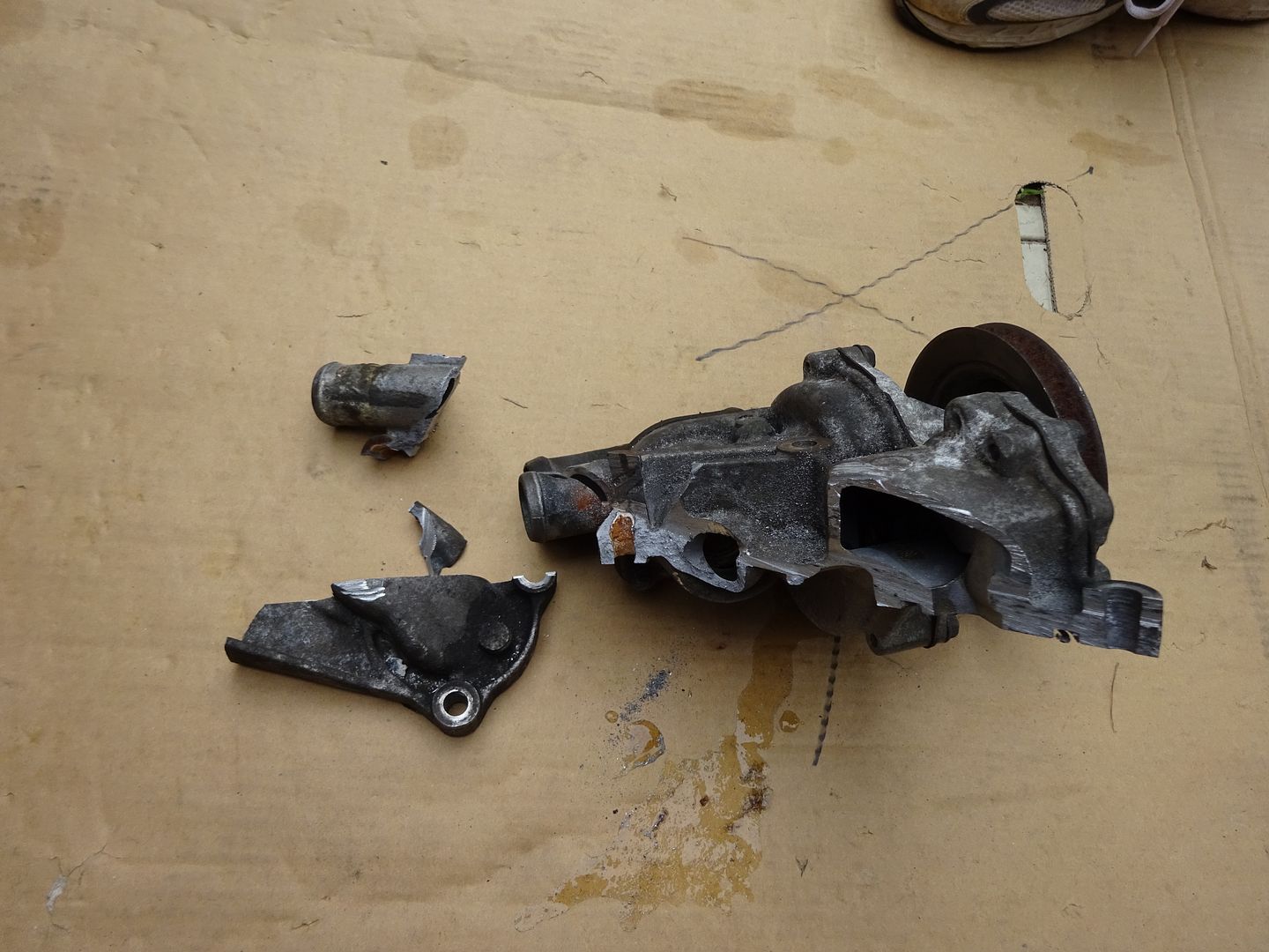

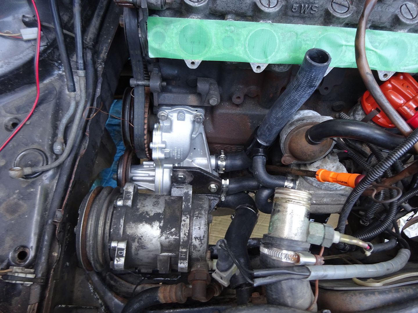

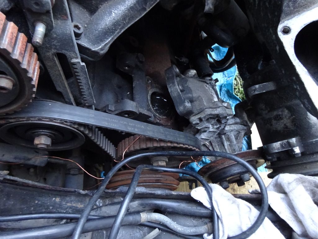

Tried to remove the water pump... but the long bolt which holding the water pump was stuck completely :bizarre:
I decided to cut out the water pump to remove it :mrgeen:

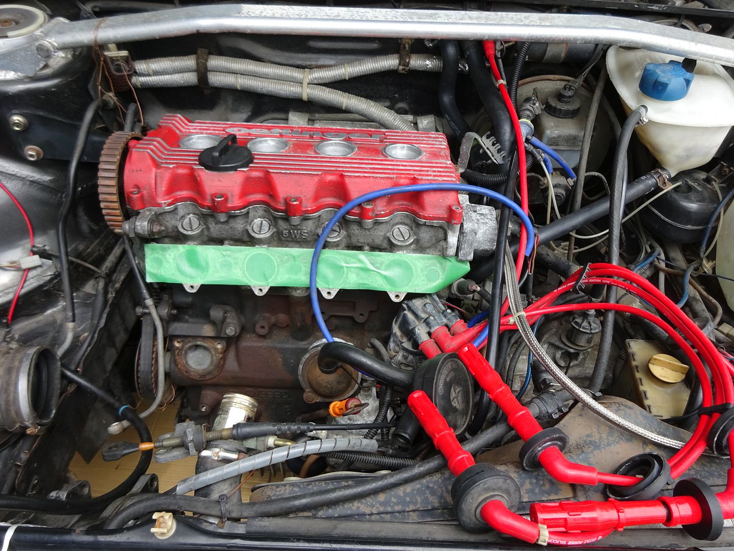

Here's little progress.
I could get to the point where I can start the engine at least.

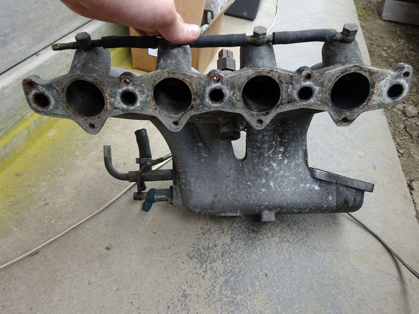

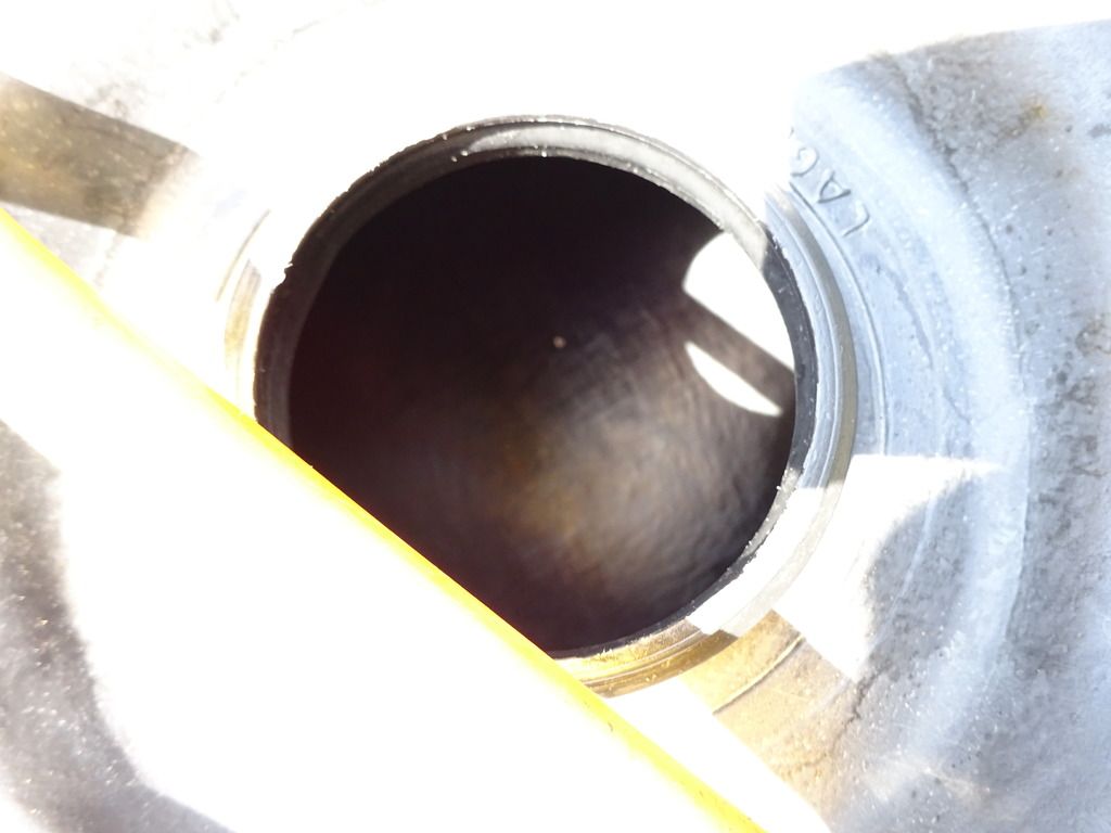

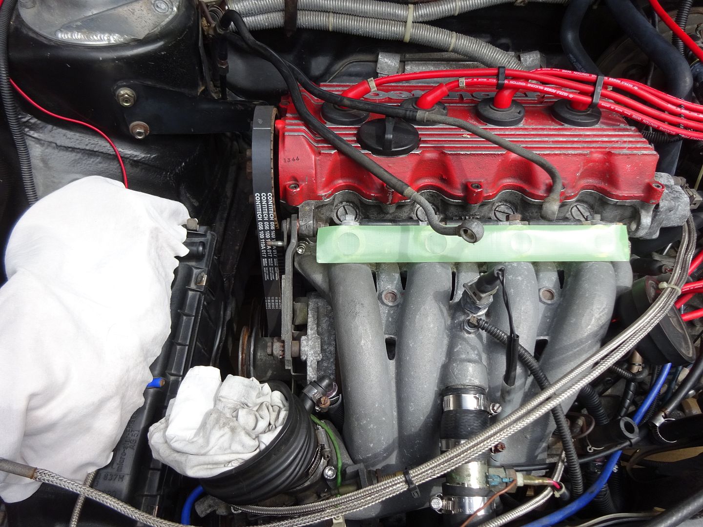

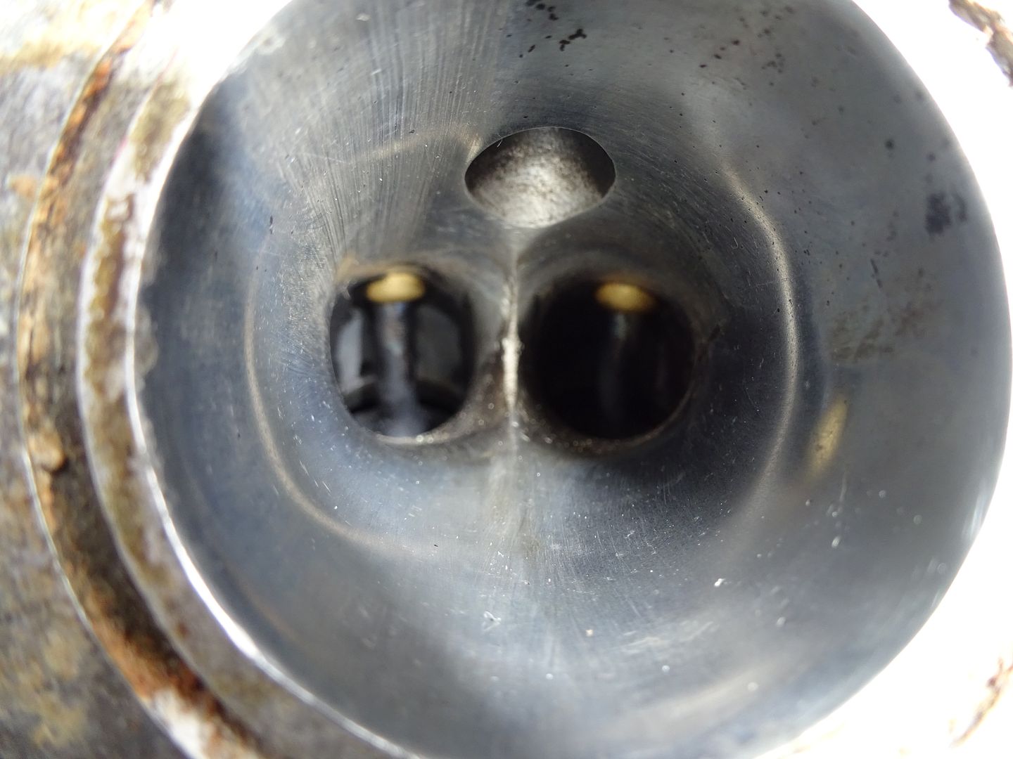

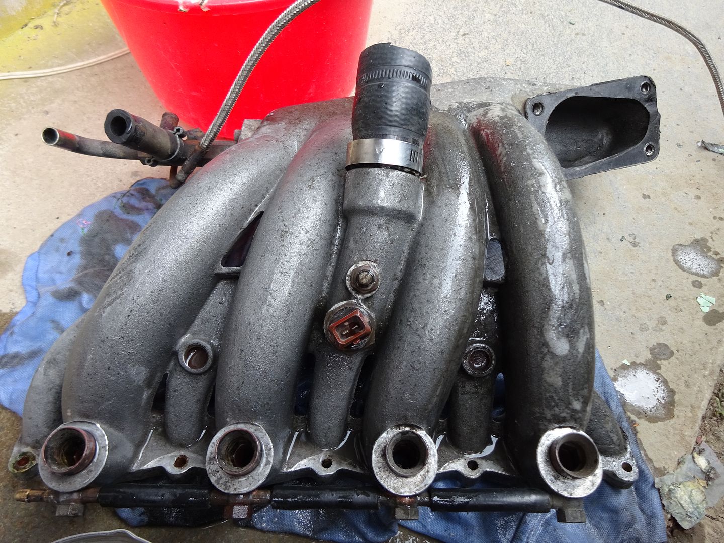

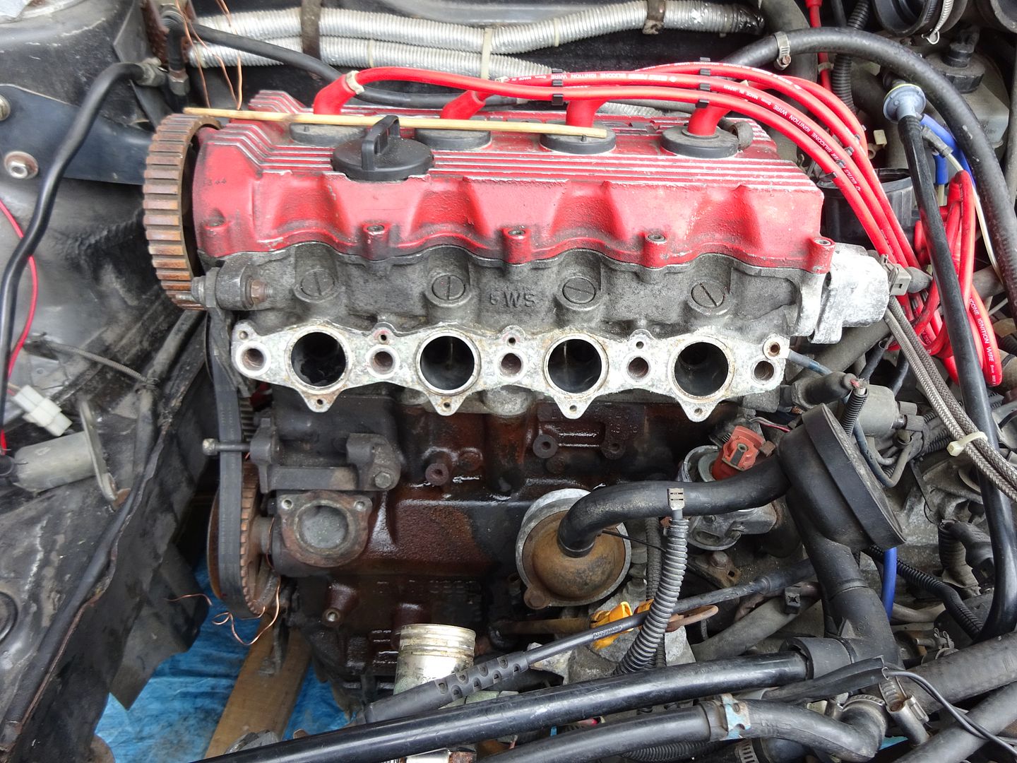

Took off the intake and clean it.
Beautiful port :bisoux:
Then re-assemble the whole parts.
And then, the time has come... :lol:

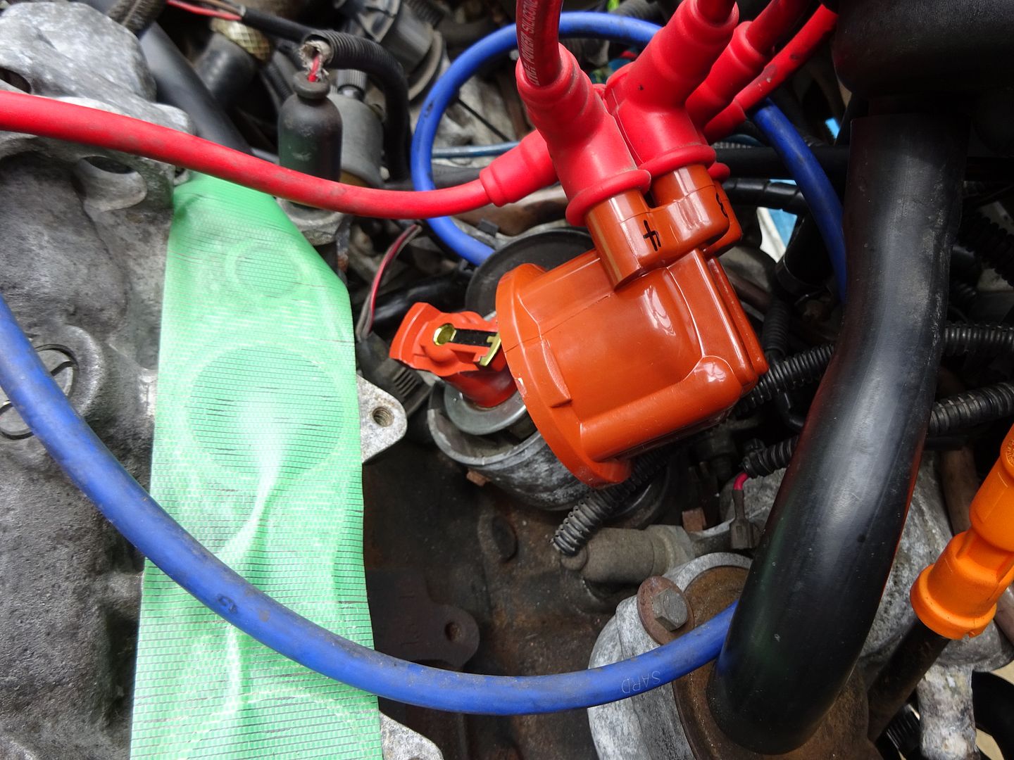

Nice! Good job guy! I suppose that the spark plug wiring comes from a japanese car?

billb a écrit :Nice! Good job guy! I suppose that the spark plug wiring comes from a japanese car?
It's not certain, but the shape looks like different from the original wiring.
